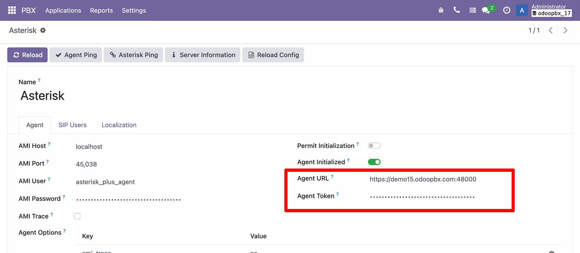

Configure Odoo to access the Agent
Go to PBX -> Settings -> Server and enter your Agent URL. Make sure you allow port 48000 on your firewall / port forwarding.

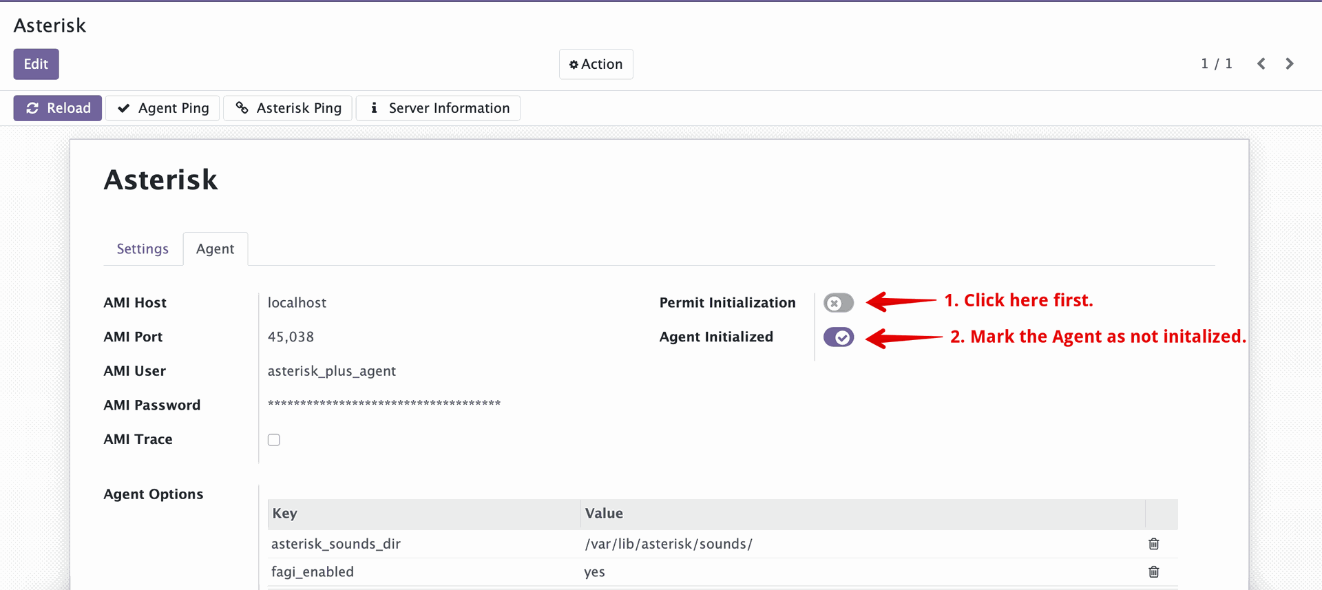

Agent connection re-initialization
Agent lost its configuration
If you run the Agent and get the error "Initialize error: Agent is already initialized" that means your docker container and volume were destroyed and the Agent configuration file was lost. To fix it you have to permit the initialization procedure as shown below.
After that run the Agent again.
Re-connect to another Odoo instance or URL
If you change your Odoo server or change your Odoo URL you need to the Agent re-connection. For this you must permit the initialization as described above, and also tell the Agent to start the initialization process by specifying the --init flag in its run command like show below:

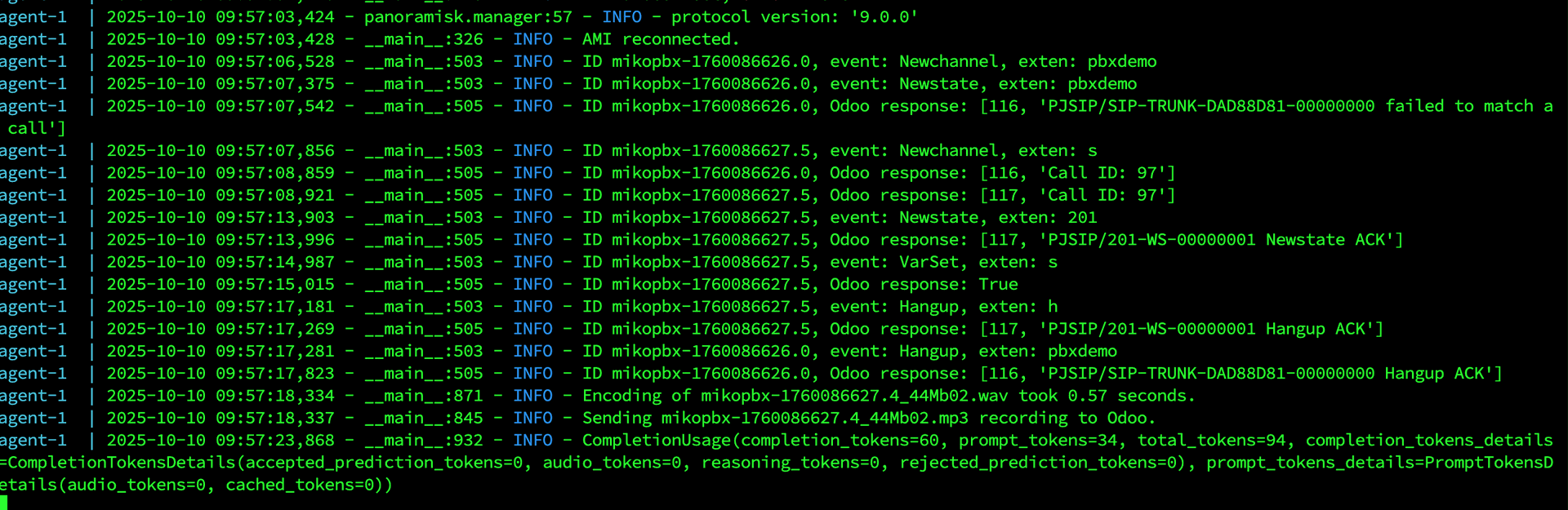

# Check the logs:
docker-compose logs agent
